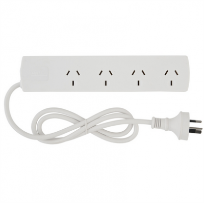

    Just to verify, so it's OK to use a standard power board with no surge / noise protection after the UPS?

    Well, when you say power board, if you mean something like this, then yes you can as long as it does NOT contain any surge and spike protection. But frankly, I cannot remember seeing any basic power centers that don't have surge and spike protection.
    If your concern is wasting power, I really would not worry about it. When computer devices these days go to "sleep" they really consume very little power. Your TV probably consumes more when you are asleep. And TV cable boxes are real power hogs even in standby. And note most UPS let you kill all output power either through a switch in front, or a master switch in back.
    Lastly, flipping a master power switch to suddenly power on all connected devices at once can actually cause a pretty big surge followed by a decent size sag until power stabilizes. These generally are not excessive, but still, in my mind, it kinda defeats one of the main purposes for having your components connected to a decent UPS with AVR in the first place. So being a bit anal about clean power, I would probably flip each of those switches (Master, then Aux 2, Aux1, Printer, Monitor, Computer) one at a time anyway - which would defeat the purpose of the box. :rolleyes:

    Bill, I mean like this:
    I think you've answered my question anyway. I really just needed an extra outlet as my unit only has three UPS outlets and three surge protected outlets.

    Yeah, that looks fine. For the record, I have connected to my UPS one of these. I really like them because first, they are only 18 inches long. And second, I don't have to worry about multiple large AC to DC power blocks fitting. So this "spider" extension cord lets me connect the power supplies for my router, modem and 4-port switch to the battery side of my UPS too, along with my computer and both monitors. :)
