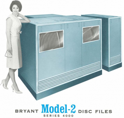

    Panagiotis, we used a lot of those and their previous gen version of 650mB.
    BUT... the first one I ever used, Circa 1968, was this one. It's total capacity was 450mB. We used to save the individual platters (after a head crash) to make patio tables... :)

    Wow... :eek::cool:.

    Wow...for the lady or.... o_O
  21. pandlouk
    pandlouk Registered Member
    Jul 15, 2007
    2,976
    :D The lady is fine but not my taste... I was born a decade later and from kid till now I never figured why that hairstyle was so popular in the sixties...
    The Wow was for Froggies comment "We used to save the individual platters (after a head crash) to make patio tables... :)"
    Panagiotis
  22. TheRollbackFrog
    Mar 1, 2011
    5,180
    The Pond - USA
    That was only if the crash wasn't too bad. When the head crash was bad, the flying magnetic head would dive into the magnetic oxide surface so hard that it would obliterate it and grind into the layer below... which just happened to be magnesium. Magnesium has this interesting property that one it starts burning, it can supply its own oxygen and burn up a storm. The platter would self ignite and burn across the entire surface, around the outside edge, and down the other side of the platter. We would have to leave it alone until it was fully burned out. The burning heat was too hot and fire extinguishers couldn't put the fire out due to the oxygen creating magnesium.
    It was like gathering around a bonfire while camping... :argh: Luckily only one or two of the 26-platters on the device would burn during a serious head crash... and those type of crashes were rare (<2> in 7-years), but a regular crash happened about once every 3-weeks on average.
