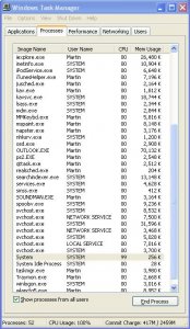

  2. ravin
    ravin Registered Member
    May 2, 2003
    241
    South Carolina
    Re: CPU Usage 100.
    looking at martinatthetown's process list I see that outlook is taking up quite a few resources. their is a known problem in outlook that after closing it outlook continues to run. so if you don't notice it didn't end and open outlook again you double up on resource usage. just a thought. allthough restarting the computer should end any instances of outlook. one last suggestion would be to get a copy of avast free - install it in safemode and select during install to scan at boot time.
  3. NICK ADSL UK
    NICK ADSL UK Administrator
    May 13, 2003
    9,506
    Re: CPU Usage 100.
    Hi martin and welcome to Wilder's :)
    In just observing your screen shot you do have far to many processes running and you really do need to check what is starting up when you turn your computer on and take the necessary steps in dealing with that issue first before attempting to do anything else.
    If you could post another screen shot of when you have rebooted your computer i will then be able to get your start up in to some sort of order for you. Just having the right start up program's running fixes many things without the need for any further intervention
    Regards

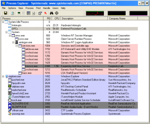

  4. martinatthetown
    martinatthetown Registered Member
    Sep 14, 2006
    10
    Re: CPU Usage 100.
    Thanks all for advice.... this is issue is starting to turn into a nightmare!
    I've restarted the computer, gone through and stopped all none essential services, the problem still continues...
    I've had this problem for acouple of days, I can identify one possible reason:
    I updated my computer with the Microsoft Update - it included 6 updates, which I have since uninstalled:
    KB919007 Update for windows XP
    KB920685 Security Update for windows
    KB922582 Security Update for windows
    KB920872 Update for windows XP
    etc
    it also contained one new hardward driver update, however, like most people, I just installed all recommendations, and paid little attention to what the hardware driver related too. the drivers are not listed on the microsoft update history
    I have been through the system-device manager tonight and painstakeingly roled back all drivers where possible, restarted the computer etc...
    the computer by the way, fails to shut down correctly, poss. because something is failing to close... I also deleted and recreated the paging-file
    my only known solution is to do a full system restore, however, my computer is my job, I have lots on it! and really can't spend a full week reloading the content - after I've backed everything up.... I'm running out of ideas...
    if I did this, whats to say, it will not happen again?
    (the computers a compaq presario, if that helps?)

    I see also that svchoste.exe and system is using quiet a lot memory. Do you have a firewall running. Sometimes application insist in accessing some internet stuff which can result, if they don't reach their destiny, in a temporaly high mem and CPU usage. Check your FW settings and log, if you use one, regarding system, svchoste.exe, etc.
  6. NICK ADSL UK
    May 13, 2003
    9,506
    Re: CPU Usage 100.
    Hi martin :)
    Can you please remove all of these from starting up as they are not needed. Should they continue to start up may i suggest that you use windows defender which will highlight what is running at start up so you can then disable those above. There is other software that you could use like reg run but i have found windows defender to do a good job
    You can find it here
    http://www.majorgeeks.com/download4466.html
    http://www.microsoft.com/athome/security/spyware/software/default.mspx
    The updates you have uninstalled should go back on when you have completed everything and i think in your case you could submit a HJ log for one of our expert's to take a look at just to make sure everything is in order
    Regards

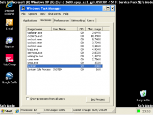

  7. martinatthetown
    Sep 14, 2006
    10
    Re: CPU Usage 100.
    Thanks again for all your advice people!
    I have not stopped fiddling with this problem as it is making my PC impossible to use.
    I agree, I need to manage my PCs configuration, and this could be effecting the performance of the machine, however, I have been using the PC, fulltime as a .NET developer, for the last 6 weeks continuously, in that time, I have not added a program, or changed the configuration.
    Bearing in mind I uninstalled the resent updates.. I just used MSCONFIG to restored the computer to a previous configuration; (to before the updates were added…) This did not solve the problem…
    so I then entered safe-mode with the basevideo option selected… as you can see from attached image… nothings really loaded, is ito_O what am i missing?

  19. dvk01
    dvk01 Global Moderator
    Oct 9, 2003
    3,131
    Loughton, Essex. UK
    Re: CPU Usage 100.
    nothing there either
    your screenshot shows 99% cpu with only minimal memory useage by system process so it must be a driver that loads in safe mode so that brings it down to the basics like Ide drivers or keyboard & mouse driver
