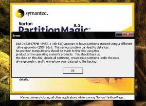

    I have been using Disk director since few weeks. I tried Partition Magic (PM 8 ) Yesterday as my friend it is better than DD (which i doubt now!!!). Whenever i have tried initializing PM 8 it always gives me this error
    I am using ACER aspire 5004 with Windows XP SP2 professional
    Disk1 : 60gb hard disk
    Disk 2 (in question i.e.one with error) : 250gb Seagate external USB hard disk
    Can someone help me regarding this ...please o_O
    I would really appreciate that?
    Thanks Again.

    I wouldn't worry about it. PM comes up with this error even when there's nothing wrong. You have formatted your drive with another utility or altered your bios settings. If you try to fix it with PM it will probably corrupt your drive! so don't try to fix! The gemoetry is seeing it different in windows to the bios. Run chkdsk and leave alone. Don't try to fix it. If the partition is reporting the right size in Disk Director then its fine.

    PartitionMagic has been dead for several years, unfortunately. PM only supports drives up to 127GB, I thought. That could be bad information. I would suggest finding a new partitioning tool - there are many to choose from. If chkdsk says the drive is fine, I wouldn't worry about it.

    I ran chkdsk , NO errors:D ... anyhow i had formated my drive with Disk director only so no point keeping PM in my laptop...
