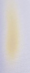

    ...problem which has just started on my Surface Book laptop, after 4 years of use. I guess there is not much I can do about it. :( Luckily, it is on the edge, only.
    P.S. Tried to capture what it looks like by taking a screenshot, but doesn't show the problem.

    Well, it makes sense a screenshot would not work. Burn-in is caused by actual damage to the display screen caused by leaving a fixed image on the screen for extended periods of time. This damage is a hardware issue and has nothing to do with the operating system or the programs running on the computer.
    A screenshot or screen "capture" or screen "grab" uses a software program to copy a portion of or all of the digital information currently being used to display an image on the screen or that portion of the screen.
    If you wanted to show others what it looks like, you would have to use a camera and take a photo of your monitor.
    Make sure it really is burn-in and not simply your contrast and brightness settings being too high. Frankly, burn-in on home computer monitors it not common because the images are constantly changing. Plus, we don't normally keep our monitors on and displaying the same image for hours and hours at a time.
    If you kept your computer running and monitor on for many hours each day displaying the exact same image all the time, then burn-in could become a problem.
    Burn-in is much more common in places like airports where, for example, the words "Departure" and "Arrival" and "Gate" are displayed in the exact same spot on the monitor 24/7. Or in places where the CNN logo might be displayed in the same corner of the TV all day long. That said, modern TVs employ "pixel shift" and other technologies to help mitigate those problems.
    See How to Fix Screen Burn on Any Screen for other possible solutions. But note if it is severe, it may never go away completely.

    Burn in is of course still a possibility but image persistence should also be considered a possibility on some displays. I get this on my TV and leaving it off long enough clears it up.
    https://en.wikipedia.org/wiki/Image_persistence

    Yeah, image persistence is addressed in the link I provided above. Basically, image persistence (or image retention) is the initial symptom of the problem and usually can be reversed. But if not addressed in time, permanent burn-in will result.
