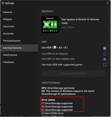

    1) To check if you have an NVMe Driver os standard Microsoft NVMe Driver, go to device manager, expand storage controllers, then right click on Standard NVM Express Controller, then choose properties, then check the driver version, if it's the standard Microsoft one, it would have a number that looks similar to your Windows Build number, this is on my Windows 11 22H3 build: 10.022621.2506
    2)
    • DirectStorage is enabled automatically if your PC supports it, so you don’t need to turn it on.
    • For DirectStorage to work, your PC needs to have an NVMe SSD and a DirectX 12 compatible graphics card.
    • To check: Press Win+G, go to gear icon > Gaming features. Check the Graphics and DirectStorage sections.

    1) pretty easy to check
    2) i'm using w10 , i don't find the gaming features ,maybe because i don't play game
    thanks ,appreciate your help and screenshot
