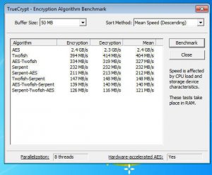

    Benchmark
    AES Encryption / Decryption 2,4 GB/s
    Serpent Encryption / Decryption 232 MB/s
    Intel Core i7 with AES-NI here.
    http://en.wikipedia.org/wiki/AES_instruction_set
    http://software.intel.com/en-us/articles/intel-advanced-encryption-standard-instructions-aes-ni/
    http://www.truecrypt.org/docs/?s=hardware-acceleration
    They mean both the encryption process for a TrueCrypt volume and system partition. "TrueCrypt does not use any of the AES-NI instructions that perform key generation."
    But in general they mean support for hardware-accelerated AES encryption.
    It depends on your HDD - is it a new SSD or a old magnetic storage?
    The SATA 3 GB/s and 6 GB/s SSD drives (find out what your mainboard chip support) can do a read performance of around 285 MB/s (3 GB/s) up to around 550MB/s (6 GB/s). SSD combined with AES plus AES-NI and you have no single bit speed loss. With Serpent and a SSD SATA 6 GB/s you will feel a speed loss. If you have an old magnetic storage with maximum 80 - 120 MB/s then you have also no speed loss with Serpent.
