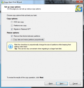

    When migrating to the 3 TB drive I'd like to keep the Windows partition at 64 GB so I uncheck "Copy data and resize partitions proportionally". After clicking Next I get and error message saying I'm out of disk space which of course is ridiculous since I got 3 TB free :rolleyes:
    I would prefer a textbox to the slider when selecting destination disk partitions size (or perhaps both?). With the slider it's impossible to configure a partition like 64 GB.

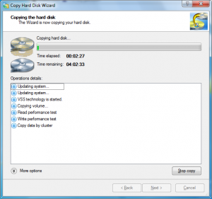

    "Time remaining" at the "Copying the hard disk" window is not accurate but what's worse is that "Time elapsed" also stalled for long periods which would drive impatient users to drastic measures.

    1) It would be great to get LOGs of migration.
    By the way, what version of Migrate to 3TB did you use? Update was released recently and should contacin some bugfixing. Build number is 10.0.16.12621
    Logs: "PWLOG.TXT", "STUBACT.LOG", "BioNTlog.TXT" in "C:\Program Files\Paragon Software\[Program Name]\Program"
    2) GPT Loader driver which is installed together with Migrate to 3TB doesn't support RAIDS.
    http://www.paragon-software.com/technologies/components/gpt-loader/win7.html
    This warning should be added for Migrate to 3TB also.
    So you will not be able to create new partition beyond the 2.2TB limit.
