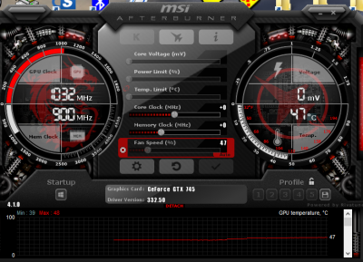

    It seems that lately whenever I watch videos on YouTube (not full-screen), the Nvidia GPU gets hot quite quickly. I monitor this via SpeedFan and MSI Afterburner, and I also noticed it's because clock-speed gets higher. It goes from 135 Mhz to 1032 Mhz, for no good reason. I can't remember if this was always the case, but is this normal, or is something not right?

    Does this happen DURING/MID video ??
    Base clock on OEM GTX 745 is 1033 -- don't see an issue unless it's happening mid-video for no good reason.
    745 can handle that temp easily - NP - nowhere near max (95C).
    Why this? Use Afterburner "on demand to cool my GPU?" You have an alarm trigger set or sumthin like that? Or you just let Afterburner control the fan? Dunno what you mean by "on demand."

    The strange thing is it happens even when browser tab are not active, so YouTube videos are running in the background. And why would the GPU need to change gears even for videos that are not displayed in HD? And it also doesn't seem to happen that often when I play videos in Media Player Classic.
    I mean that normally speaking I only run MSI Afterburner if I'm playing video-games. This means that normally my GPU fans are not auto controlled, which is risky in case temp rises. You would think that the GPU was able to control fan-speed itself, but apparently it can't. On my old HP desktop I used SpeedFan, but it doesn't seem to recognize the Nvidia GPU.

    Yes, it will allow me to play the newest games. But it's really weird, I noticed that even when fan-speed goes up, the temp barely lowers, so something is definitely up. BTW, I'm also thinking about buying the Acer Nitro 5 laptop, for playing video-games in the bed and living room. It will probably cost a 1000 bucks, not that bad.

    Can you actually hear the fan blowing at high speeds??

    I have just checked it, I can indeed hear them, so that's a good thing. Temp never seems to go above 50 degrees, so I guess I'm not at risk that much. But perhaps it's indeed the dust, will soon try cleaning it.
