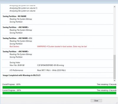

    I did not try this before - I used Image for Windows instead and did not run into any errors. I then used Macrium to do an image on another pc using the same destination external drive and that worked fine too. Will try your idea with the Macrium Boot media tomorrow.
    Edit: ran the image from the rescue media and while it went through successfully, it came with a warning that 4 clusters are in a bad sector and data might be lost. I guess I will need
    to change the drives urgently.
  2. beethoven
    beethoven Registered Member
    Dec 27, 2004
    1,420
    So, now I wonder what is the best way to fix this issue? The OS drive does not really contain any important information except for the MS License, all relevant data is saved on a different drive (E). The OS C-drive is large 1TB but less than 100 GB are used. Can I reduce the current C-drive to a smaller size to fit a 250gb SSD and if so , what is the easiest way to do. Then if I were to use my existing image to recreate this machine, will that mean I import the bad clusters too?

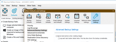

    See if you can repair the bad sectors with...
    chkdsk /r
    This will take a long time as the full 1 TB needs to be scanned. Then create a backup image to be used for your next SSD.
  4. kronckew
    kronckew Registered Member
    Aug 27, 2006
    482
    CSA Consulate, Glos., UK
    You can try using the 'ignore bad' option. Try chkdsk c: /r first
    Try to use 'intelligent sector copy' option to only image used sectors, hopefully nothing will be in the bad sectors. if they are at the 'bottom' 3/4 you may be able to bypass them by using windows disk manager to shrink the system partition away from the bad bits & just image that part.
