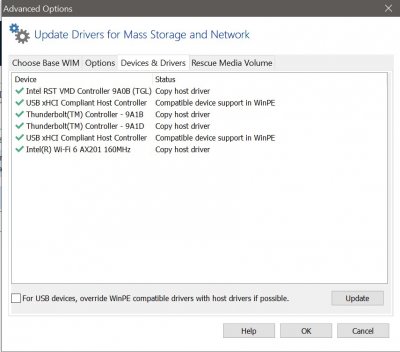

    A friend of mine used the Acronis BootCD program for PC backup for several years.
    Now he bought a notebook Asus zenbook UX425EA and has big problems with backup: all programs refused to backup this laptop!
    I advised him the Macrium program. He created MacriumRescue.iso WinPE10 (Free) ver. 7.3.5854, but the flash drive with Macrium still (like Acronis BootCD) does not see nvme ssd !!
    I advised him to create MacriumRescue.iso WinRE.
    Now the program detects nvme ssd and he made a backup of his laptop!
    However, he is unhappy because he wanted to use MacriumRescue.iso WinPE10
    What advice can you give?
    Perhaps his problem stemmed from Thunderbolt 4 with display / power support, USB Type-C standard?
    Notebook Asus zenbook UX425EA.

    Is this NVMe SSD connected through a Thunderbolt enclosure? If not, then I'm not sure why you're looking at Thunderbolt drivers. If the problem is instead that the internal storage is not detected, then if the system is set to RAID mode in the BIOS rather than AHCI mode, the issue is likely that the WinPE 10 build doesn't have the appropriate Intel Rapid Storage driver installed. You could try having him check the WinRE build's \Driver\Disk folder to see if there are any folders in there. If so, copy them to the WinPE 10 build's \Drivers\Disk folder and see if that resolves it. If it does, then you can copy that folder into the Rescue Media build folder on your system so that all future Rescue Media builds will always include that driver. You can even do that for drivers that aren't relevant to the system where you're building Rescue Media in case you want to use one PC to build Rescue Media that will be usable by multiple PCs.
    If there's no difference in the Drivers folders of those two builds, then it does sound like the WinRE build has some native drivers that aren't available on WinPE 10. Out of curiosity, why does your friend want to use WinPE rather than WinRE if WinRE works, especially if WinPE 10 doesn't?
    The other option would be to switch your system to AHCI mode, which will work unless your friend is actually using an actual RAID setup or Intel Optane storage. But switching from RAID to AHCI on an existing Windows installation requires some work to get your system to keep booting. Normally that change is only made before reinstalling Windows. But there are guides for how to switch from RAID to AHCI in-place.

    You hit the bull's eye!
    The problem is that there is no Intel Rapid Storage driver in WinPE .. although why can't Microsoft add this driver if it affects the System boot ?? My friend read your post, downloaded this driver, https://downloadcenter.intel.com/do...el-Optane-Memory-10th-and-11th-Gen-Platforms-
    used your advice and it worked! We both thank you!

    Microsoft does have an Intel Rapid Storage driver in WinPE. But newer generations of Rapid Storage controllers sometimes need newer driver versions. It's possible that the system you have requires a newer version of the driver than was built into WinPE 10 1709, which after all is over 3 years old at this point. Glad to hear you got it sorted though. :)

    Unfortunately, WinPE10, and even its latest version WinPE10_2004, does not contain a complete set of drivers that are required for a backup...:(
    Perhaps you have your own Driver-Pack that contains the missing drivers?
    I mean these drivers, https://downloadcenter.intel.com/do...el-Optane-Memory-10th-and-11th-Gen-Platforms-
    and also this post of yours https://forum.macrium.com/45598/Restore-from-SD?PageIndex=1 Perhaps any drivers should be added as well? If you do not have such a Driver-Pack, then perhaps you can make one?

    The Windows Recovery partition can be customized on each system, including having additional drivers relevant to your system injected into it. This is BEFORE Reflect even touches it. So that could be why Rescue Media builds based on WinRE have drivers that are useful for your system built in even if those drivers are missing from newer WinPE 10 releases.
    In terms of creating a driver pack though, I don't think that would be feasible, and even if it were, it could become quite large and would be mostly bloat for a large chunk of users. Reflect already supposed to examine your own system to add any additional drivers that are necessary for that system. I'm not sure exactly why that isn't working in this case, although the Intel RST driver can be challenging. Intel has reused the same PCI DEV ID for multiple generations of RST controllers, so that can cause older RST drivers to be considered valid for newer controllers even though those older drivers won't actually work properly. So that strange choice on Intel's part might be causing Reflect to determine that the built-in RST driver is suitable for your system's RST controller. However, Reflect also recently introduced a way to deal with this, in fact this new feature was my own suggestion to the Macrium team a while ago, and it was finally implemented. If you open Rescue Media Builder and click Advanced > Devices & Drivers, select the Intel RST controller, and click Update Driver > Use host driver. That will force Rescue Media Builder to pull the RST driver out of your Windows environment rather than relying on the one built into WinPE.
    If for some reason that doesn't work here, the manual way to add drivers would be to go to C:\boot\macrium, then open the Drivers folder for the WinPE/RE Rescue build you want to customize. In there you'll find a few more subfolders for various device types. Inside any of those subfolders, you can create a new subfolder with any name you want, like IntelRST, and then copy the necessary driver files into that new subfolder. From that point on, Reflect will include those drivers in any future Rescue Media builds that use that WinPE/RE version, even if it doesn't think those drivers are necessary or applicable to your system. In the case of Intel RST, you would want to download the "F6 floppy" version (that's a reference to the old Windows XP Setup days....) since that contains the raw drivers without any installer packaging. Good luck!

    Everything is much simpler ... VMD Intel (R) Rapid Storage Technology Driver is missing in WinPE10_1709 / 1809/1903/2004.
    This driver is also missing in Windows 10...
    However, without this driver, the Windows 10 bootloader does not see the NVMe SSD, so it is impossible to install Windows 10!
    https://www.asus.com/en/support/FAQ/1044458/
    This is a pretty funny situation, especially if you paid $ 1,500 for a new laptop. :D

    The VMD variation of the driver is relatively new in the life of the Intel RST controller history, so I guess the Win10 built-in driver library hasn't caught up. It's a constant game of cat and mouse. But it's not especially unusual to need storage drivers when installing Windows if you've got a brand new system. It happened even more often back when Windows only got major updates every few years rather than every 6 months. For example, Windows 7 has no native support for NVMe or USB 3.x, and since users held onto it a lot longer than expected, needing manually provided drivers to install it onto new systems became pretty common. The USB 3.x issue in particular was a challenge, because on some systems that only had USB 3.x ports, it was possible to boot from a Win7 flash drive in a USB 3.x port since the system firmware controlled the USB interface during boot, but after the system handed USB control over to WinPE 3.1 (Windows 7 Setup), then you would lose USB access since it didn't have built-in support for USB 3.x controllers. So at that point, Windows 7 Setup would be unable to see the flash drive that it had just booted from. The fix was to inject the necessary USB 3.x drivers into the boot.wim file of the Win7 setup media, but that was a bit of a chore. (The NVMe limitation had two possible workarounds. One was to use the RST controller, in which case the NVMe interface was abstracted from the OS, but then you still needed the RST driver. The second option was to get the Windows 7 hotfixes created by Microsoft that added native NVMe support to Windows 7 and inject them into the boot.wim and install.wim files of your install media, but that again was a bit of a hassle, and those hotfixes were never officially offered through Windows Update. They had to be manually downloaded and were advertised as not having the same level of testing and support as regular updates.)
    I'm sure that in a year or so once that system is no longer cutting edge, installing whatever version of Windows 10 is current at that time won't require any manually provided driver. Or like I said, depending on the storage solution you're using, you could just switch the system to AHCI mode instead, which disables the RST controller completely and instead gives the OS direct access to the storage interface, and since Win10 has native support for NVMe, you wouldn't need an additional driver at that point.
