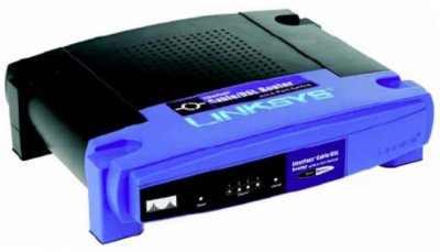

    Hats off to my Little Router on the Prairie...

    I have one of those, now residing in my Historic Device Carton.
    The need for a gigabit LAN for efficiant NAS backups required its retirement. :(
