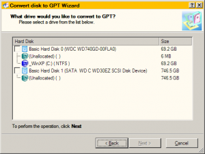

    I am using Win XP Pro SP3. Both "Convert disk to GPT Wizard" and "Create New Partition Wizard" could see only 746.5 GB on my WD Caviar Green 3 TB disk. Re-installed the GPT Loader many times but no difference.

    3. Please post here a screenshot of Convert Hard Disk to GPT wizard where incorrectly recognized 3TB drive is shown.

    The drive is directly connected to one of the motherboard's (Gigabyte GA-965P-DS4) SATA port.
    Log files and screenshot attached.

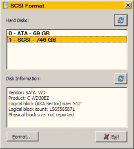

    4. Screenshot of scsiformat utility:
    * Download scsiformat utility from Paragon FTP:
    http://ftp.paragon.eu.com/support/scsiformat.zip
    * Unzip the archive
    * Run scsiformat.exe file
    * Select problem Hard Drive from the list of connected Disks
    * Press 'PrintScreen' key on the keyboard to capture the screen into the Windows Clipboard;
    * Start any graphical editor (Windows Paint, for instance)
    * Create new picture, paste the image (Ctrl+V) and save it;

  6. Mech_An
    Mech_An Registered Member
    Mar 29, 2010
    855
    The reason is that your 3TB drive is recognized as SCSI device, not as SATA device.
    GPT Loader uses standard SATA\IDE commands and SCSI devices can't work with SATA\IDE commands.
    It means that you have third-part HDD controller driver installed (e.g. Nvidia or AMD driver).
    In your situation the 3TB drive appears to be connected via JMicron chip, used for RAID and/or for extra IDE and SATA port.
    Please try to disable JMicron in BIOS
