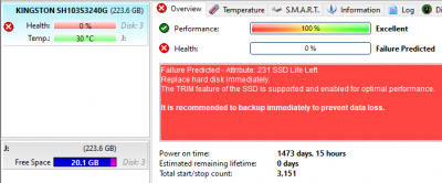

    Here's what 'overview' tab shows here -
    See post #3 or screenshot.
    EDIT: Just to add, I don't think this is app specific. That info (NAND writes) shows fine for my new SSD in both apps.
