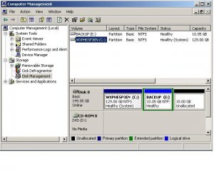

    My Partitions:

    A) maybe my HDD is dying? (physical disk - error reading)
    B) 0. physical disk is C:\ or E:\?

    check windows event viewer for errors on the disk and or run chkdsk command to check. Although I don't think hd is going bad it does not hurt to check.
