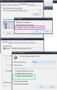

    Hi Firecat. all settings were already same as u told, except that modem comression was enabled that I disabled.( What about the option "show terminal window" just below it- it was unchecked and I left like this).
    There is option "Negotiate multitask for single link connections" under PPP settings, it was unchecked so I left like this( marked red in snapshot). Is it ok?
    Hope it might work.

    The option "Negotiate multilink for single link connections" is enabled by default for me, and my ISP recommends enabling it. You should disable it only if you have a problem.
    Modem compression should be left disabled, if software compression is enabled. :)
    The terminal window does not affect the performance of your modem, it is best to leave it disabled.

    So where is the option of software compression. Thanks.

    In the screenshot that you have posted in a previous post, it is the option above "enable multilink for single link connections", and according to the screenshot, it seems to be enabled.
    Do you have an internal or external modem?

    Most modem tweak guides say that software compression is better for internal modems. More specifically, software compression is better for:
    WinModem/Soft Modems
    HSP-based modems
    Controllerless modems
    If the modem hardware can do full hardware processing, then modem hardware compression is the better thing.
