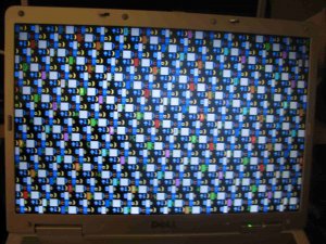

  6. stevenz
    stevenz Registered Member
    Jan 24, 2008
    74
    Check this out.
    This has just started happening.
    It is a dell 9400 inspiron.
    Dell replaced the video card and the motherboard.
    Still happens.
    Any ideas.?
