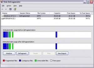

    Hi
    I have seen such thing in most computers, and no matter howmany times I do defrag, there is always a strip of data located in the middle or somewhere(as seen in pic). why is that. isn't defragmentation suppose to push data as well toward the begining. Any danger for example in resizing such a hard disk. Thank you
      44.9 KB
      308

    There are a few NTFS system files that cannot be moved.
    One of them is the MFT, master file table (which stores information about the location and other things about files on the hdd). This usually gets put in the middle of a partition and would matchup with the screenshot.
    Plenty of info if you google unmoveable files in ntfs.

    Im guessing thats one big file there, and if it is, im sure it is after the MFT and MFT reserved space.
    Why ? Because the ntfs driver will put a file in the smallest space it will fit (plus space for exspansion) and im guessing that rather large space after the MFT is the smallest space according to above.

    the computer is fine and no problem from files being there."diskeeper lite" pushed the strip further to the right, "contig" did nothing,in safe mode nothing, but the amazing "dirms" pushed every thing to the begining (top horizontal strip), however windows defrag puts it back again (bottom horizontal strip), why is that.

    NTFS allocates free space for files to grow, when files are written, it is designed to allow/use fragmented space to prevent files fragmenting which is a bigger performance hit than space fragmentation.
    If you consolidate the space perfectly, all that can happen is that any file that is subsequently modified will fragment, there is no space for the files to grow.
    If there are plenty of space fragments NTFS will try and allocate the fragments as nearby as possible (improves chances of the disc and os caches caching the file), when space is consolidated the file will have to spread its fragments much further, which is a big peformance hit in head seeks... on disc caching and OS caching is more likely to totally miss caching the fragments.
