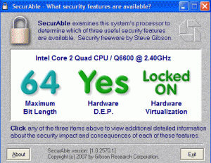

    Are we talking software DEP only, because I have both, i.e. hardware DEP.
    Just wondering.

    Hardware DEP and Software DEP should effectively be the same except that Hardware DEP will be more difficult to circumvent/ possibly have less of a performance hit (if DEP would ever have a performance hit...)
