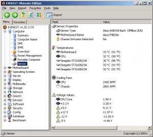

  16. Bruce Mahnke
    Bruce Mahnke Registered Member
    May 21, 2005
    629
    Woodbury, MN USA
    LSU Engineer,
    I have a couple of additional thoughts about your problem. Since your corruption problem only occurs in the new PC, and with consideration for the checks that you have made, one has to ask what other factors could be contributing. Two thoughts come to mind since creating an image certainly works the PC very hard.
    1. Excessively high temperature [hard drive(s), CPU etc.].
    2. A voltage that is out of specification, particularily when under load.
    To monitor some of these parameters I use a utility from Lavalys called Everest Ultimate Edition. They have a trial version but it doesn’t include many parameters (hard drive temps as an example). Their web site is here and screen shot of my system’s sensor page follows. A full report is over 100 pages.
    http://www.lavalys.com/
