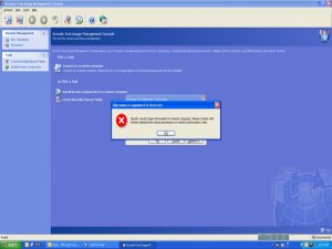

    A few days ago I suddenly lost the ability to connect to a remote
    computer using our management console. I had just been in there
    the day before performing backup job maintenance. Now when I try
    to connect to the remote computer using either the computer name or the IP address I receive the following error:
    Username or Password is Incorrect
    Specify correct logon information for remote computer. Please contact with system administrator about permissions or remote authorization rules.
    I uninstalled the agent from the remote computer and attempted to reinstall it. The only way that I could connect through the management console to was to use the server IP instead of the name. However after the installation completed I am still unable to connect. I've checked the services and they are running.

    In case anyone cares, I have resolved the issue on my own. My boss had plugged my 2nd ISCSI SAN network connection into a main LAN switch instead of the redundant SAN switch, which was causing Acronis to not resolve the IP address of the server correctly.
