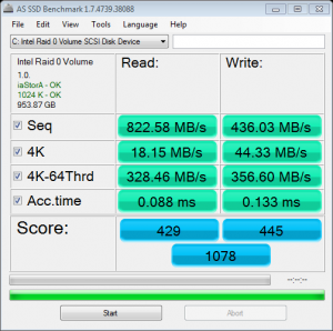

    * RAID 0, Stripe Size 32KB (I've tested and it's a major improvement from the standard stripe size of 128 )
    * 2x SSD Crucial M4
    * NTFS, Default allocation unit size
    * Updated drivers and firmware
    * DiskCryptor 1.0.757.115, AES
    * TRIM ENABLED AND WORKING
    Write caching disabled:
    [​IMG]
    Write caching enabled (not recommended with full disk encryption because you might have to force shut down or dismount and you will lose data):
