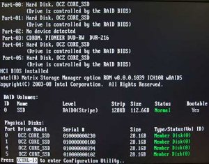

    Hi I've recently enabled raid 0 on my Gigabyte EP45 Extreme P45 chipset board with ICH10R with 4x32GB OCZ Core SSD disks. But I also use a Pioneer 216 SATA based DVD writer on the same ICH10R.
    I can boot to the Pioneer 216 SATA based dvd writer with my WinXP Pro SP3 cd to install windows, can boot using Memtest86+ v2.01 cd rom as well.
    But when it comes to Acronis T11 8101 build recovery cd, I can't get it to boot it's totally ignored and just boots into windows even with CD rom listed as first boot device in bios ?
    Do I need ICH10R raid drivers for T11 recovery cd to boot ?
    included screenshots of the SATA port configuration
    thanks
    George

    what happens when you change AHCI to IDE-option (e.g. NativeIDE) in your Bios?

    Yes, you are right.
    And I see in the pictures (post #1) that Raid0 is in work.
