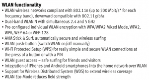

    this router has build-in Ethernet and WiFi Virtual LAN segmentation
