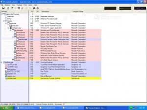

    Oh, sorry I didn't mention about the threads thing. I couldn't really understand what it was written in there but Process Explorer shows a different CPU usage than Task Manager but the CPU usage at the bottom is still always 100%. The system is around 20-30% in Process Explorer, DPC is around 50%, Interrupts is about 20-30% and the other random things are about 1% sometimes. I don't know if that will help, but i don't really understand the other stuff.:mad:

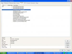

    You also still never mentioned what it actually shows in the Threads tab as taking up the CPU. You might post a screenshot, preferably including the rest of Process Explorer as well.

    Okay, for the services thing I don't know what to do. For the Process Explorer thing I have the screenshots of the threads and the whole Process Explorer. The Process Explorer shows a different amount of CPU usage than Task Manager so i'm saying this again. For some reason I can't put two of the screen shots so I will put the other one in the next post.

    Here is the second screenshot. Have fun!

    Process Explorer is the same thing (first screenshot), it just gives more info and in a more organized manner.
    Process Explorer is just being more explicit, task manager doesn't show DPCs or Hardware Interrupts, and likely just puts them all together into the "system process".
    I'd say Gerardwil probably has it there.. I'd start by just updating all drivers. If you have an nVidia graphics card, and updating all drivers doesn't help, you might try uninstalling the nVidia driver and just use the Microsoft one (which should automatically install after you uninstall the nVidia driver and reboot).

    Regarding to your snapshot you have a unusual high DPC usage, which results mostly from video drivers - have been torturing Google :)
    A so called interrupt storm that is generated by the ACPI driver causes a Windows Server 2003-based or a Windows XP-based computer to stop responding. Responsable file is Acpi.sys. There is a regitry patch available, give it a try.
    http://support.microsoft.com/kb/834631/
