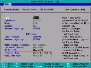

    - First of all please check if DMA for a certain channel/controller is enabled in BIOS (please see the attached file).

    I have followed the instructions and still the same problem.
