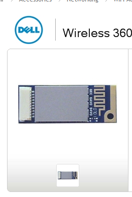

    Do you have a removeable bluetooth module installed in the device? Maybe it's time to start looking in that direction. Don't mean to be silly but is bluetooth enabled in Settings/Devices/Bluetooth? What are Bluetooth services set to in services.msc--Automatic?

    Yes, I understood the issue from the get-go. It sounds like the drivers you're loading are the right ones; but bluetooth should then be working under all conditions and it's obviously not. If you can rule out Windows borkiness (like running troubleshooter for network adapter and power) and you can't isolate the update you suspect is the cause, then as a last resort, consider replacing the bluetooth module. Is running a hardware diagnostic going to yield anything useful?
    http://www.dell.com/support/home/us/en/19/quicktest
    This is what I meant by a removable bluetooth module in my earlier post.
