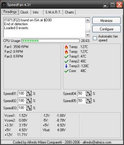

    I´ve installed SpeedFan (SF) and as you can see on the pic, it looks like something is terribly wrong, should I take this seriously? I have to say that the reason why I installed SF was because my system is making a high toned sound, and I wanted to see if everything is OK. I´m not sure yet what the problem exactly is, but I´m going to clean my PC soon.
    But this 117C (242F) temp looks a bit scary especially because it also sometimes gives me a normal temp (35C). I´m not sure what "Remote 2" is though.
    However, my system doesn´t feel hot or anything, and it´s also very stable. Strangely enough, my system acted a bit unstable before I even heard this strange sound, my system would crash sometimes and Process Explorer could not measure my CPU usage correctly anymore, but these problems disappeared after uninstalling some apps, so I thought it might be a software conflict. :rolleyes:

    That is your graphics card that is cooking itself. you need to make sure the card fan is running if it has one. did you possibly have on board graphics and have added another graphics card??

    How do you know that it´s my graphic card? And no I have not replaced anything on my system. How could this happen? Just yesterday I got normal temps and now it´s cooking itself again? :ninja:
    As you can see on the pic both of my fans are runing at 40% speed, I have to say that even when my CPU is used intensively I never hear my fans running any faster, I always thought this is kind of strange. Btw, I can control both of my fans with SF, so they do seem to be working? :blink:

    you probably have a CPU fan and a case fan that are being reported you graphics card fan most likely wouldn't be reported just the temp. if it has a graphics card fan you can open the comp case and see if it is running. Speed fan is calling my graphics the same as yours and I also check my comp temp useing Everest http://www.majorgeeks.com/download4181.html you might want to try everest to see if the temps are the same as SF.
    aux. is the graphics card.

    here is a picture of the speed fan on my pc and two temps are red.
    hope you can help me identify.

    It's not unusual for SpeedFan to display some strange readings. Usually I untick the obviously wrong readings in the Configure dialogue. Note the references to double 127C readings here: http://www.almico.com/forumvotes.php?id=309.

    quote " Always shows 127C on Asus K8N-E" thats my mobo so at least i now know and can safely untick those in config

    most software monitoring aps pull the basic temp data off the SMBus (System Management Bus)
    http://www.smbus.org/
    but that has gotten a bit more compicated recently
    problems arise when they incorrectly identify the various sensor chips employed with a given mobo, the best default solution is to check the temperature status inside the BIOS itself since its reading the same bus and "knows" how to interpret the data
    (but verify your BIOS version has no temperature related updates as well)
    there are so many possible combinations of sensors and so many mobos out there its often difficult to get the "automatic" portion of recognition down.

    My aux is running at 127c. Why is this? This obviously cannot be right.

    Why is my Aux at 127c? Please look at my screenshot.

    this link shows that some motherboards show 127c at all times
    my asus mobo always shows two 127c all the time in speedfan but its wrong as writen in the link above.

    Ive had sensors read as the most wild readings possible
    (-130C CPU for instance :eek: I wish :p)
    and its happened with most aps, sorting it out is sometimes tricky
    at one point I was running a 3 inch squirrel cage blower fed AC air with a short duct to the CPU heatsink, whenever the AC would start a new cooling cycle the exhaust from the heatsink would wash over the mobo sensor location and the CPU temperature appear to be lower than the mobo temperature by a degree or so. I relate this to point out that micro-circulation factors can effect what you think is happening system wide and why there are advantages to getting a seperate sensor system like a DigitalDoc (8xthermistors) inorder to "map" the thermal gradient within a case.
    The accuracy of all your sensors are debatable even the ones in the CPU socket, and the ones incorporated in the CPU core, while what they are measuring (typically electrical resistance) is a given, the adjustments to those readings to reflect actual temperature of an adjacent component (socket measuring CPU) or portion of a component (core sensor measuring an adjacent portion of the core which doesnt have a uniform thermal gradient) is what those pesky BIOS revisions are often adressing, then you add the additional level of the software reading and interpreting those numbers off a given bus. MBM for instance allows you to even add your own "windage" adjustments to increase accuracy if you have reliable data.
    A changing wild reading is generally a misidentification, a static wild reading is generally something trying to be read that isnt there.

    I think it´s probably a false positive in SpeedFan, what happens is that after reboot I get extremely high temps, but then I put my system in standby, start it again after 10 seconds, and suddenly I´m getting normal temps. And besides, if my video card has been frying itself for the last month I don´t think it would work anymore. :rolleyes:
