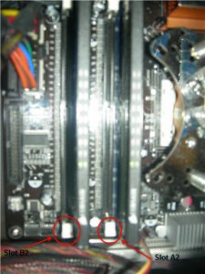

The precautions I'll certainly follow; I'm comfortable with installing/uninstalling hardware, just not certain until now about the mixing of two memory brands. It looks like the Corsairs are already in slots A1 & B1, so I should just be able to drop (carefully, of course ) the new sticks into A2 & B2 and all should work. A friend of mine looked up the specs on the corsairs and feels it will be difficult to match their latency specs with stock Kingston or Patriot sticks - the two I'm considering, so I would imagine the speed of the slower RAM will prevail. That's alright with me. The machine is approaching 4 yrs now, so I don't want to fork out the big $$ for another matched pair of the Corsairs. I'm most interested in utilizing 4GB memory so Win 7's x64 can fully realize its memory management to full effectiveness.
