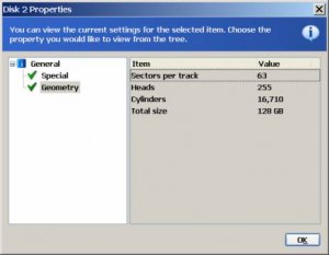

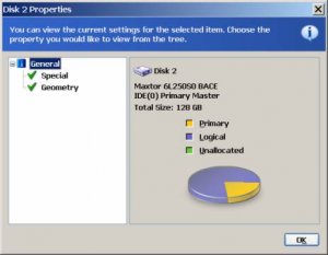

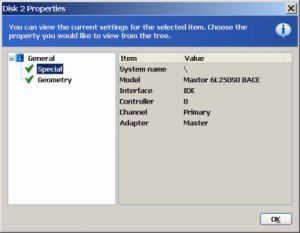

  6. jomagar
    jomagar Registered Member
    Jun 17, 2006
    8
    perdon, i don't now print the report.
    the information of hdd is the image jpg adjunt
      18.8 KB
      131
  7. jomagar
    Jun 17, 2006
    8
    image two
      17.9 KB

  8. jomagar
    Jun 17, 2006
    8
    third image

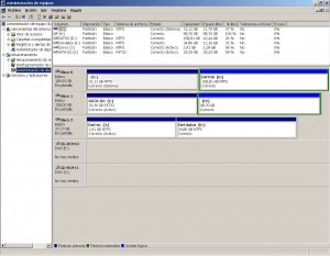

  9. Acronis Support
    Apr 28, 2004
    25,885
    Hello jomagar,
    Could you please clarify whether Windows recognizes this hard drive as 250 GB?
    Could you please create a screen shot of the internal Disk Management utility (Start -> Settings -> Control Panel -> Administrative Tools -> Computer Management -> Disk Management)?
    Thank you.
    Kirill Omelchenko
  10. jomagar
    Jun 17, 2006
    8
    is the disk 1 , only have 128gb, when is a hdd of 250gb
    before the partition 2 had 200gb.
    thanks.
      155.9 KB
      4
  11. Acronis Support
    Apr 28, 2004
    25,885
    Hello jomagar,
    Please update your BIOS and let us know the results.
    Thank you.
    Kirill Omelchenko
