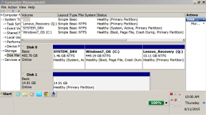

    My Lenovo T450s laptop just arrived a couple of days ago. Attached is a screenshot of the Windows 7 64 Pro setup conataining the 500 GB system drive with a System reserved partition, a Recovery partition and a separate 16 GB cache drive to help speed boot. Partition style of C drive is Master Boot Record (MBR). I want to transfer the system drive to a 256 GB m.2 SSD which I will install soon. I could just use the Lenovo recovery USB I made but then I would have to open the system up twice, leaving my new HDD for data out the first time so the recovery USB will only see the SSD. Fopr imaging I might be more comfortable using my Image for Linux USB.
    If I decide to image, I will need to do a lot of prep I believe such as deleting the recovery partition, resizing the system drive to around 150 GB to be safe, uninstalling Express cache proram and wiping 16GB SSD to have no conflicts there since I will use this for pagefile anyway, making sure defrag scheduling and system restore are turned off for C drive. There may be other things for me to do but these are some I know of. Then, make the image with IFL 2.93 of the whole disk, install m.2 ssd and blank HDD for data, restore disk image to SSD with IFL, gussing I need to set alignment to 2048. And then, hopefully it will boot Windows 7 Pro. What do you think of this? Am I missing something and do you believe this is feasable? Also, do you think I would manually have to invoke TRIM after restoring and thanks for all help.

    I haven't worked with a SSD/HD cache setup so I can't help with that aspect. You seem on top of those details.
    Do you have BIBM? I ask because sometimes the OS doesn't boot after you delete the Recovery partition. So if you delete the partition with BIBM (don't select Clear Boot Sector) and the OS doesn't boot, you can Undelete the partition with BIBM.
    I agree with your image/restore approach but I'd use the latest version of IFL. When making the boot disk (use the Custom mode) select Align Partitions on 1MiB Boundaries. Create an Entire Drive image. When restoring, do an Entire Drive restore with these Options...
    Scale to Fit
    Align to Target
    Log Results to File
    Check TRIM is enabled by using this line from an Admin Command prompt...
    fsutil behavior query disabledeletenotify
    ... the answer should be 0 if TRIM is enabled. If you don't see 0 then use...
    fsutil behavior set disabledeletenotify 0
