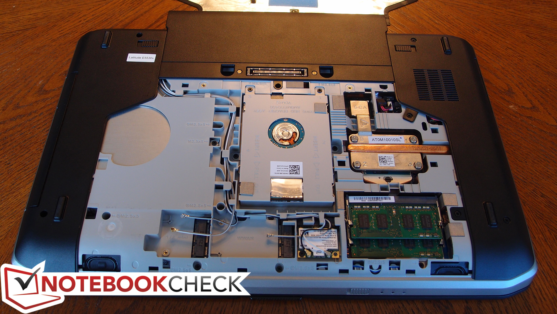

  17. Baserk
    Baserk Registered Member
    Apr 14, 2008
    1,321
    AmstelodamUM
    The specs of the laptop read 'Wireless: South African Intel Centrino Advanced-N 6205 (802.11 a/b/g/n) Half Mini Card, Built in 3G,...'.
    If I look at this Dell E5530 review screenshot of the back-side, it shows an empty 1/2 mini-card slot on the left and an empty full mini-card slot for a WWAN/3G module; link
    Is your laptop actually equipped with a 3G module?
    if not, you might want to consider placing a small SSD there over time/whenever you see one offered at a nice discount.
  18. Ocky
    Ocky Registered Member
    May 6, 2006
    2,713
    George, S.Africa
    Hello Baserk, yes it has a SIM card slot, which I suppose is for a 3G card, i.e. one could take it out of the cell/smart phone and insert it there.
