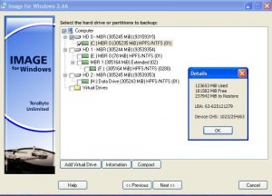

    I finally bit the bullet after having problems with FD_ISR, i.e last remaining accessible snapshot.
    So, IFW is now installed in that snapshot.
    I went to create my first backup of C:, but decided it didn't seem right, i.e 237942 MiB to restore.
    I am not sure how to proceed at this stage.
  2. Brian K
    Brian K Imaging Specialist
    Jan 28, 2005
    12,175
    NSW, Australia
    Tarnak,
    That looks fine. IFW does sector based restores so if your original partition was....( * is sectors in use, - is free space)
    then the target partition to restore into can not be smaller than...
    The Details box is telling you there is 123653 MB of data but that data is spread over the first 237942 MB of the partition. So the smallest partition you can restore your image into is 237942 MB. Your current partition is 305235 MB.
    If you wanted to restore your image into a partition between 123653 and 237942 MB in size you could either resize the partition smaller before creating the image or use the Compact option in IFW. But usually you don't to want to restore into a smaller partition anyway.

    Just a point on terminology. Your HD 0 contains a single partition, the C: drive. So the HD is "partitioned".
    You should like IFW. Just run through the screens. On the Options screen leave the ticks in Pagefile, Hibernation and log. I choose Validate Byte-for-Byte unless I'm in a hurry. But mostly my images are created automatically so I don't know it's happening and I continue to work away.

    I thought you had WinXP in view of the 63 sector partition offset on HD 0.
    Yes, in Win7 there are 2 imagew.exe in Task Manager.
  11. Tarnak
    Tarnak Registered Member
    Feb 5, 2007
    5,295
    I don't understand, I am running XP....but, "63 sector partition offset on HD 0.".....It is Gobbledygook, to me. o_O
  12. Brian K
    Jan 28, 2005
    12,175
    NSW, Australia
    In your graphic it shows LBA: 63-625121279
    This means the first partition starts on LBA-63. Win7 OS partitions usually (not always) start on LBA-2048

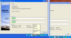

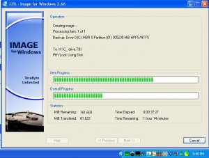

    My progress so far...
  14. Brian K
    Jan 28, 2005
    12,175
    NSW, Australia
    Looking good. How does your computer feel? Most people barely notice a decrease in performance but the occasional person can't "use" their computer. Not sure why.

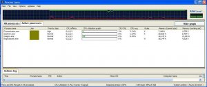

  15. Tarnak
    Feb 5, 2007
    5,295
    I use Process Lasso, to see how system is performing...
  16. Tarnak
    Feb 5, 2007
    5,295
    Sorry, to say that my system froze after about 100 minutes, with 55% completed.
    The mouse cursor would freeze for seconds at a time, unfreeze for a second or two, freeze. Put up with this for about 45 minutes,then rebooted.
    After the reboot, Tiny Watcher informed that PHYLOCK.SWP was created on C: Also, a TBI image file has been created on H: which is obviously, is incomplete.
    I guess it would be safe to delete both files, and retry, but I will wait for you to advise me.
  17. Brian K
    Jan 28, 2005
    12,175
    NSW, Australia
    That would have been in the Validate stage after the image had been created. So let's see if we can find out what happened. Delete the PHYLOCK.SWP but keep the .tbi.
    From IFW, run a Validate on the .tbi file. Let us know what happens. Validate tests the ability of your hardware to restore an image rather than testing for a bad file. I'll discuss Validate failure if it happens again.

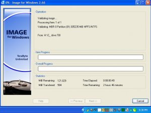

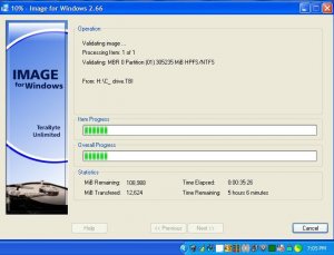

  18. Tarnak
    Feb 5, 2007
    5,295
    Running the validate...looks like it has some time to go. ;)

  20. Tarnak
    Feb 5, 2007
    5,295
    The freeze problem occurred again. Needed to reboot.
    See screenshots. The last one, was a matter of luck, considering the freezing problem.
  21. Brian K
    Jan 28, 2005
    12,175
    NSW, Australia
    I'm glad you selected Validate. If you hadn't, the image would have been created and we wouldn't have known about the probable hardware issue. It is most likely bad RAM. If you had tried to restore this image it would not have restored.
    Out of interest, you could install IFW on another computer, copy the .tbi to that computer and then try to Validate the image. It should Validate on another computer.

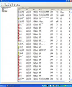

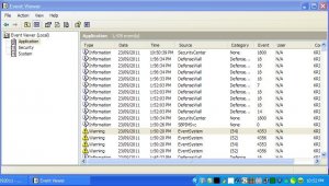

  23. Tarnak
    Feb 5, 2007
    5,295
    Just checked the Event Viewer logs. Seems something is going on, to say the least.
  24. Brian K
    Jan 28, 2005
    12,175
    NSW, Australia
    Tarnak,
    The first thing I'd check is your RAM as outlined in the TeraByte link I posted. Use memtest86+ (ver 4.2) from a boot CD.
    http://www.memtest.org/#downiso
    Errors usually appear within seconds but sometimes you have to run it overnight. Good luck.
