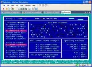

    I've not used hdd regenerator but Spinrite using level 4 (maintenance) will 'refresh' the drive, not a low level format in itself, that's now lost to modern drives but it reads and rewrites the data at the low level while analysing the disk.
    Spinrite maintenance, realtime...
