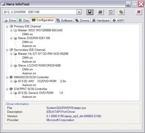

    OLD HDD - WD-120GB - C-Partition (41GB) and D-Partition (71GB). This drive boots fine - SMART issuing errors.
    NEW HDD IDE - Seagate 250GB/16MB - Never been installed - Currently jumper set to Cable Select
    Installed Programs - TI9/3854 and DD10/2160.
    Experience - Above average - I'm not a builder - Not familiar with MOBO / HDD Hardware configuration .. but a fast learn.
    See JPG - ALL Drives - Current Configuration - Nero Info Tools
    Would like to keep this HDD change as painless as possible.
    To temporarily slave in the new HDD for cloning process, can I use one of the optical drive cable sets for connection. (see JPG for current config). With computer OFF ...
    Which optical drive cable sets should I choose to connect new drive up to??
    Which optical drive do I put in TI9 rescue disk in??

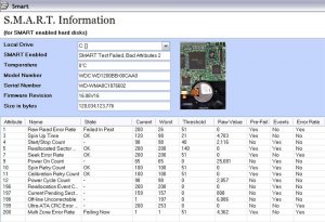

    Do you have any backup images created before you started to see SMART errors. Who knows what files system errors are present on your failing HD now. You don't want these being transferred to the new HD.
  3. Dennis L
    Dennis L Registered Member
    Jul 7, 2006
    46
    Central Wisconsin - USA
    Have BEFORE and AFTER images.
    Computer working great, but SMART stating HDD failure could occur. See jpg of SMART results.
