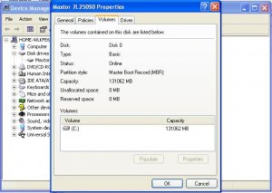

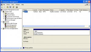

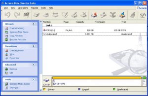

    Hey guys, wondered if any of you would be able to help me out. I wanted to reformat my 250GB hard disk, however I had 80GB worth of data I didn't want to lose. Using Disk Director, I created an 80GB partition called "backup" (which was known as my F:\ drive) and then reformatted my C:\ partition using the Windows XP setup routine. Now I have a completely clean 124GB partition called C:\ but that's all; my computer genuinely thinks I only have a 127GB hard disk and I can't find any trace of my backup partition, or the data on it! :'( , any help would be much obliged because I'm genuinely stumped. Thanks in advance!

    Can you post a screenshot of what Windows Disk Management shows and what DD (in Manual Mode) shows for the drive?
    Have you tried the Recover Partitions Wizard in DD to see if it finds the "backup" partition?
    I would post the screenshots first before you try the Recovery Wizard (if you haven't already). It will help to see how Windows and DD see the disk before any "recovery" tools are run.
    If you need help creating and posting screenshots, see this post and this post.

    Here are the screenshots buddy; I've actually got 125gig that's disappeared into thin air, :'(. Even the recover partitions wizard did nothing!

    In addition to the BIOS, what does DD report from the boot CD? Does it see two partitions?

    Problem solved, :D . Turned out as soon as I installed SP2, even though Windows displayed my drive through my computer as still being 125gig, in Windows Disk Management and DD there was another mass of space shown unallocated! After running the DD partition recovery wizard all my data's back too. Thanks so much for your help guys, really appreciated it. This one proper stumped me.
