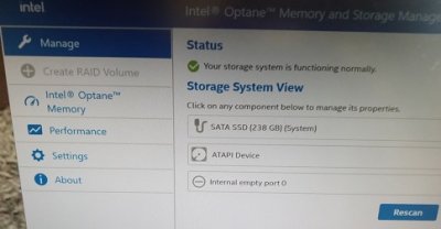

    How does this Optane memory configuration fit in? Can it be turned off?

  7. TheKid7
    TheKid7 Registered Member
    Jul 22, 2006
    3,595
    UEFI
    BIOS MAIN MENU 01.jpg BIOS MAIN MENU 01.jpg C_DRIVE PARTITIONS.jpg INTEL MANAGE 01.jpg INTEL MANAGE OPTANE MEMORY 02.jpg

    Thanks. Looks good. UEFI.
    Are you still planning to transfer the OS to the new SSD or leave it on the current NVMe SSD?
