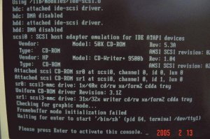

    After that please create Acronis Bootable CD with the new build and try booting from it. If the problem remains please boot your computer from the Acronis True Image rescue disc and press F11 key when the "Starting Acronis Loader..." message appears. After you get the "Linux Kernel Settings" prompt, please remove the "quiet" word, click on the "OK" button and create the shots of the output displayed on the screen. Please send the shots to support@acronis.com along with the link to this thread.

    I have the same problem as ablib....
    Using Build 796 to create an Acronis Bootable CD does not produce a workable CD.
    I am using Windows XP SP2 with all the available updates.
    I am sending 2 screenshots (Digital Camera) directly to support

    Could you please boot your computer from the Acronis True Image rescue disc and press F11 key when the "Starting Acronis Loader..." message appears? After you get the "Linux Kernel Settings" prompt, please remove the "quiet" word, click on the "OK" button and wait for # prompt to appear. Please insert a diskette into a floppy disk drive and issue the following commands:
    cd tmp
    mkdir mntdir
    mount /devfs/floppy/0 mntdir
    sysinfo > mntdir/sysinfo.txt
    umount mntdir
    Also please issue the following command:
    cat /proc/fb
    and put down the output (if any).
    Please send the sysinfo.txt file from the diskette and the output from the command to support@acronis.com along with the link to this thread and indicate in the subject of the letter that you want to contact Ilya Toytman. I will help you with the solution.
