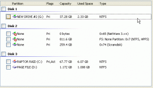

    Hello,
    Need some guidance on bad sector error. My system is as in sig and I am using Trial version of ATi (build 613). When Ati first loads after launch it "analyzes partitions" and gives the following error for one of my 80GB maxtor PATA drives:
    SEE END OF POST
    I have never had a prob with this HD in past but, naturally, I reformatted without probs and then went to CMD mode and did a chkdisk /R. No bad sectors were found. I rebooted and launched ATi again but same thing. It finds 6 sectors in all (same ones each time).
    After "ignoring" all these from the error dialog box, ATi loads and when I examine the drives using the 'create image' function this is what it says....
    plz see next post as I can only put one image per post.....

    The report is below. The raid and the other maxtor PATA drive 'NEW DRIVE #2' are ok, but you can see what it thinks of the other PATA drive. So, is my drive bad eventhough scandisk and chkdsk say it's fine? Is it ATi causing the probs? Any ideas??

    Here is the info for the PATA Maxtor drive that Acronis TI is having probs with. BTW, TheQuest, I saw your edit and just to let you know, the IC7-MAX3 does not have a Via chipset. It is Intel 875P.
    Anyway, if it will help, here are all the sectors that came up bad on Acronis TI.
    218,129,509
    218,129,637
    218,129,525
    218,129,511
    218,129,512
    729,050,305
    These are reproducible each time ATI is launched and Windows Explorer is able to read/write to drive. Same bad sectors came up after running chkdsk and then reformatting.
    Ok, the smartmon dump is below:
