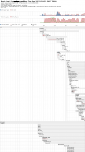

    I am not quite sure where to find the problem - have taken the liberty of
    uploading the bootchart image for your perusal ... time permitting of course :p
    I will also ask a friend more knowledgeable than I am to check.
    There is of course this big gap after init ...

    Ummm wow... everything seems to start to load about 15seconds in the boot process.

  7. Mrkvonic
    Mrkvonic Linux Systems Expert
    May 9, 2005
    10,221
    Took a look. The things that take time are the initialization of hardware, namely your ata/sata devices. Did you enable new devices in bios when you plugged in the new drives? Perhaps you can test by disabling one by one and see if things change? You might have a faulty sata cable or such alike or maybe too little power on one of the ports. Also try disabling/enabling ahci in bios for each of these devices, see if this helps.

    added - see my first post. Bootchart shows that everything loads after
    roughly 15+ seconds - no bottlenecks after that delay.
