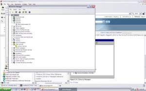

    Could I trouble you for what exactly the device tree is and where to find it? Is it the window you get when you click on Device Manager?

  12. Longboard

  13. ThunderZ
    ThunderZ Registered Member
    May 1, 2006
    2,459
    North central Ohio, U.S.A.
    Sorry bgoodman4. Missed your question. Longboard has you covered.
    Thanks Longboard.
    From past experience I am going to guess it is linked to "Computer".

    Ah, I did not think it would/could be that easy. The pic is attached. I am going to take a close look at the 2 links provided earlier today (links follow) during the day (Thursday), it is now 4:04 am and I need to get to sleep but as soon as I have anything to report I will do so. Also, of course, if anyone has any further thoughts or comments I am anxious to hear them.

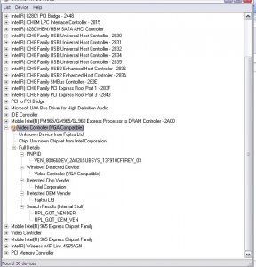

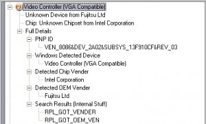

    I downloaded the linked to (above) program Unknown Devices (excellent little program by the way) and it appears to have identified the unknown device. Details are provided in the attached. Not at all sure how to proceed at this point. Probably I should go to the Fujitsu site and search for the drivers for this but ,,,,,,,,,

  20. MrBrian
    MrBrian Registered Member
    Feb 24, 2008
    6,032
    I google'd ven_8086&dev_2a02&subsys_13f910cf&rev_03; both results mentioned Mobile Intel 965 Express Chipset Family.
