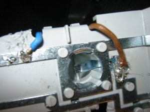

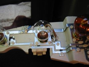

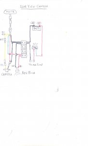

Hi, I installed a rear view camera kit on my car, it works fine whilst the gear lever is in reverse, but am not sure if the connections are what they should be. Although the advert fotos give connection Info, I got conflicting info from ventors:- 1. please check the MONITOR other RED ANG BLACK WIRE whether CONNECT WELL WITH CAR POWER or not. 2. The CAMERA RED AND BLACK POWER CABLE NEED CONNECT WITH PARKING LIGHT POSITIVE AND NEGIATIVE too So it can work auto when you parking only 3. I SEE, THE BLUE WIRE YOU CAN CONNECT OR NOT, BUT IF YOU CONNECTED, THERE WILL AUTO TURN ON ONCE YOU PACKING The Blue wire from the monitor, in the fotos, presumably makes rear view to appear if it is connected to the (+) of the reverse light. The schematic wiring a drew in my fotos shows how I connected it & works OK Can anybody work out what is the correct way & provide me with a proper wiring diagram? ...thanx .....nick
