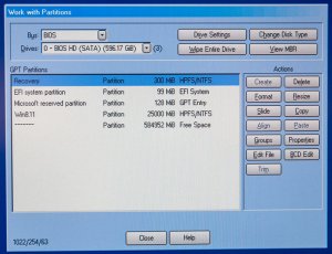

    Can you look at the partitions with a BootIt Bare Metal CD or UFD. I'm familiar with BIBM. Let's see if that phantom partition is visible and if so we should be able to remove it.
    Download the trial BIBM...
    http://www.terabyteunlimited.com/downloads-bootit-bare-metal.htm
    unzip
    double click makedisk.exe, next
    dot in BootIt Bare Metal, next
    dot in I accept the agreement, next
    don't select Image for DOS (GUI), next
    dot in Mouse Support Enabled, next
    dot in VESA Video, next
    dot in Video Mode 1024*768 - 64K Colors, next
    dot in Partition Work (Don't put a dot in Normal), next
    don't choose any Device Options, next
    tick in Enable USB 1.1 (UHCI), next
    tick in Align partitions on 1MiB Boundaries, next
    ignore Additional bootitbm.ini Options, next
    select your CD burner drive letter (you can use a CD-RW or a CD-R disc)
    Finish
    for flash drives instead of a CD ...
    select your UFD drive letter
    for USB Layout select "Partition - MBR FAT/FAT32 Partition (Int13h Extensions)"
    for Geometry Calculation Method select "Default - Use Device"
    Finish
    Boot BIBM in MBR (Legacy) mode, it doesn't boot in UEFI mode.
    It boots into Work with Partitions. You will see...
    Bus BIOS
    Drives 0 - BIOS HD.....
    You should see "GPT Partitions" above the big white rectangle
    What's in the big white rectangle? Partition name, Partition size in MiB and File System.
    It looks like this....

  25. Brian K
    Brian K Imaging Specialist
    Jan 28, 2005
    12,175
    NSW, Australia
    You aren't showing file extensions. It makes life easier if you show extensions because there are two makedisk files in the download. To show file extensions, double click "This PC", View, Options, View tab, remove the tick in "Hide extensions for known file types", click OK.
    Now it's time to unzip the download.
    Right click the downloaded "bootitbm_en_trial.zip"
    Extract All
    put a tick in "Show extracted files when complete"
    Extract
    You are now in the "bootitbm_en_trial" folder (just created). It contains 12 files
    You will see makedisk.cfg and makedisk.exe
    Double click makedisk.exe
