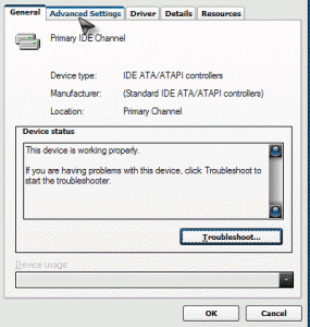

    My thoughts here are that there might be something with the drive, although not necessarily hardware.
    First thing I would do is go into "My Computer", right click on your C: drive, switch to the "Tools" tab, under "Error Checking" click "Check Now", tick "check for and attempt to recover bad sectors" and click start.
    If that doesn't turn up anything, then right click on My Computer, select properties, go to the "Hardware" tab, click "Device Manager", expand "IDE/ATAPI controllers", double click on "Primary IDE Channel", go to the "Advanced" tab, and tell us what is says in the "Current Transfer Mode" space.

    I opened the control panel and not my computer and found the device manager, when I clicked on the PRIMARY CHANNEL I didn't see an advance tab. It said that this device is working properly.

    There should be 5 tabs.. General, Advanced Settings, Driver, Details, and Resources. You don't see any of those?
    Also, did you run the error check?

    I don't have the cd's for this computer. I have it for the other sony, but they don't work for this one. I was doing the disk check, there are 5 steps, on the 4 out of 5 one it stalls on 21%. All the rest came out Ok.
    There are 4 tabs in the primary channel, the advanced setting one is not there. Does it have to be in safe mode?

    Did it fully stall or simply take a long time to get through that section? Did the process finish? Was this during the surface testing phase? There is a basic explanation of CHKDSK available to somewhat explain what is going on.
    If you hardware doesn't support Advanced features, that tab won't appear, so don't worry if it doesn't show.
